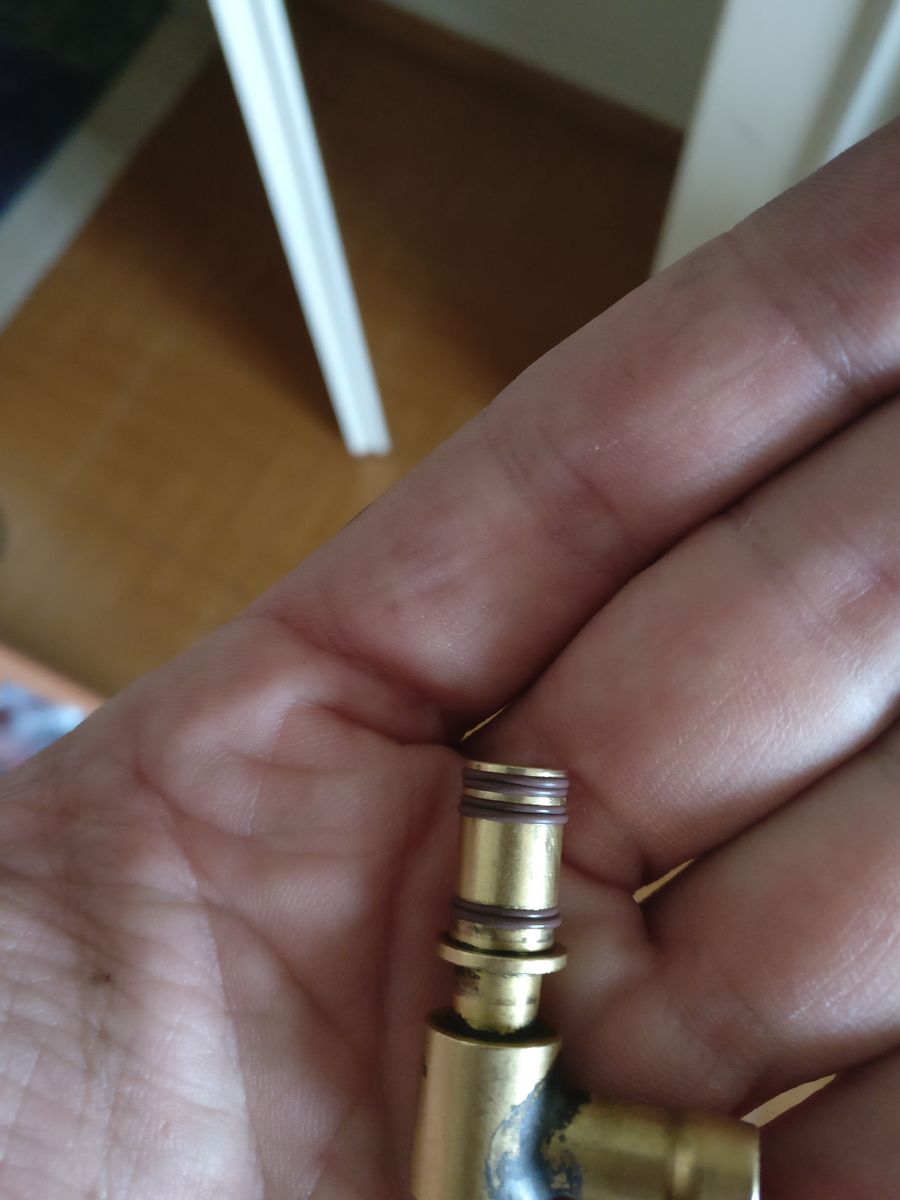

I replaced the o-rings with 2 smaller-sized viton o-rings five years ago. Never had an issue with that mod. Don't exactly remember size but these o-rings were quite common, especially when compared to that odd sized original o-ring.
Probably they will outlast the carburetors.

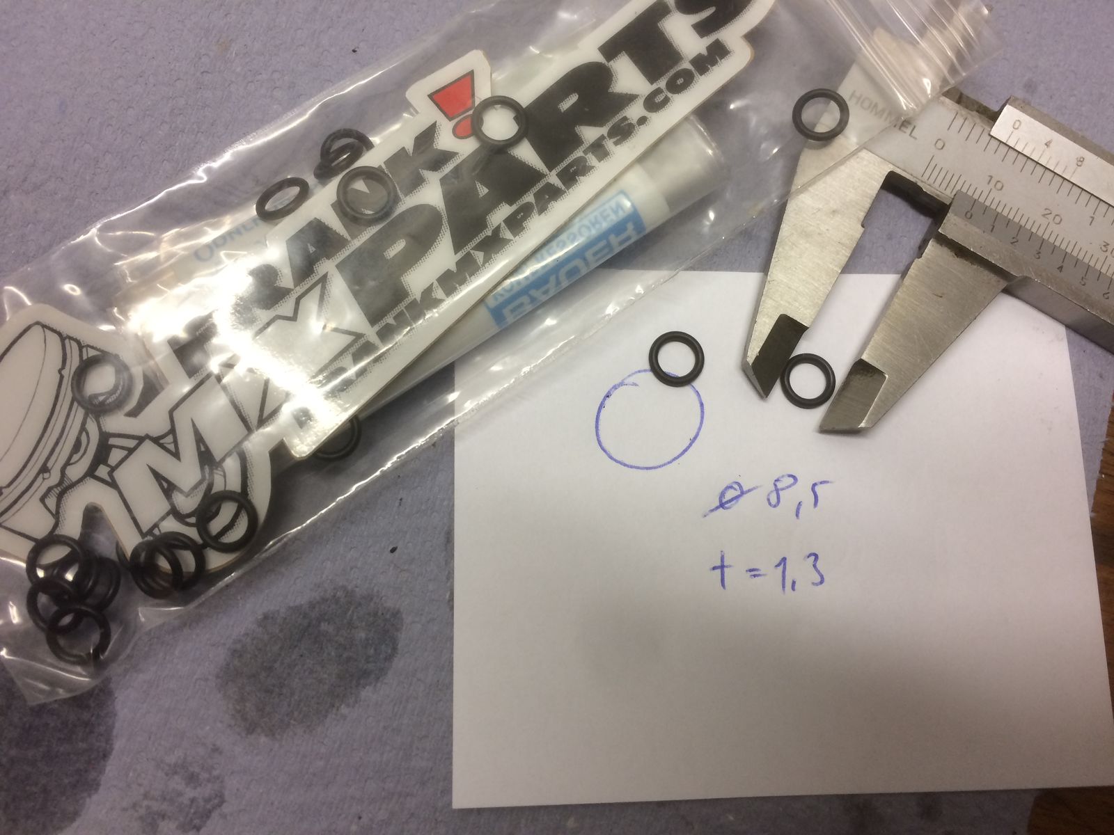

Hallo
Ich hab mir auch 30 Stück O-Ringe bei Frank bestellt.
Aussendurchmesser ca 8,5mm
Dicke 1,3mm
