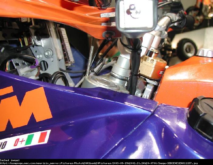

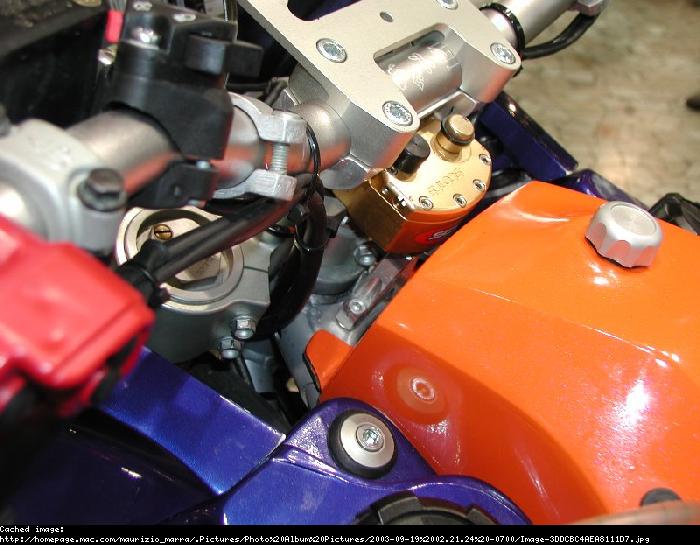

this is a question for expert... maybe KTMSOMMER could explain...
KTM will made a part to fix SCOTTS or OHLINS steering dumper on the 950?
this are image take from LC8 dakar... that is very similar from LC4 and 660 rally...
but the 950 is very different... there's 4 holes... and the raisers are much higher and inclined...

hello,
us info from scott said, they will check details. i don't belive ktm will sell "own" steering demper.
do you really think a demper is necessary?
for your rallye use you can add a longer chain to get a 22mm longer wheelbase. please use built in pre load adjuster in fork = fix them totaly to right.
best regards sommer ktm rainer kroll

thank's a lot...
friends who are just coming from a big trip in SOUTH AFRICA and NAMIBIA says that 950 is difficult to control in off road over 100 kmh....
a damper will help...
so we have to wait SCOTTS...
