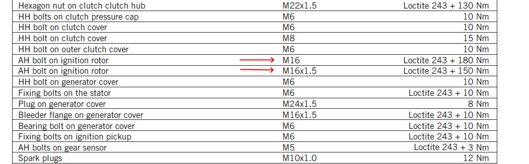

180nm blink das würde erklären, warum sich das wieder gelöst hat. Zum Glück habe ich sicherheitshalber nun wenigstens 170nm genommen. 8rgendwo habe ich gelesen, das schraubenfest für Wellen in hochfest da mit dran soll.

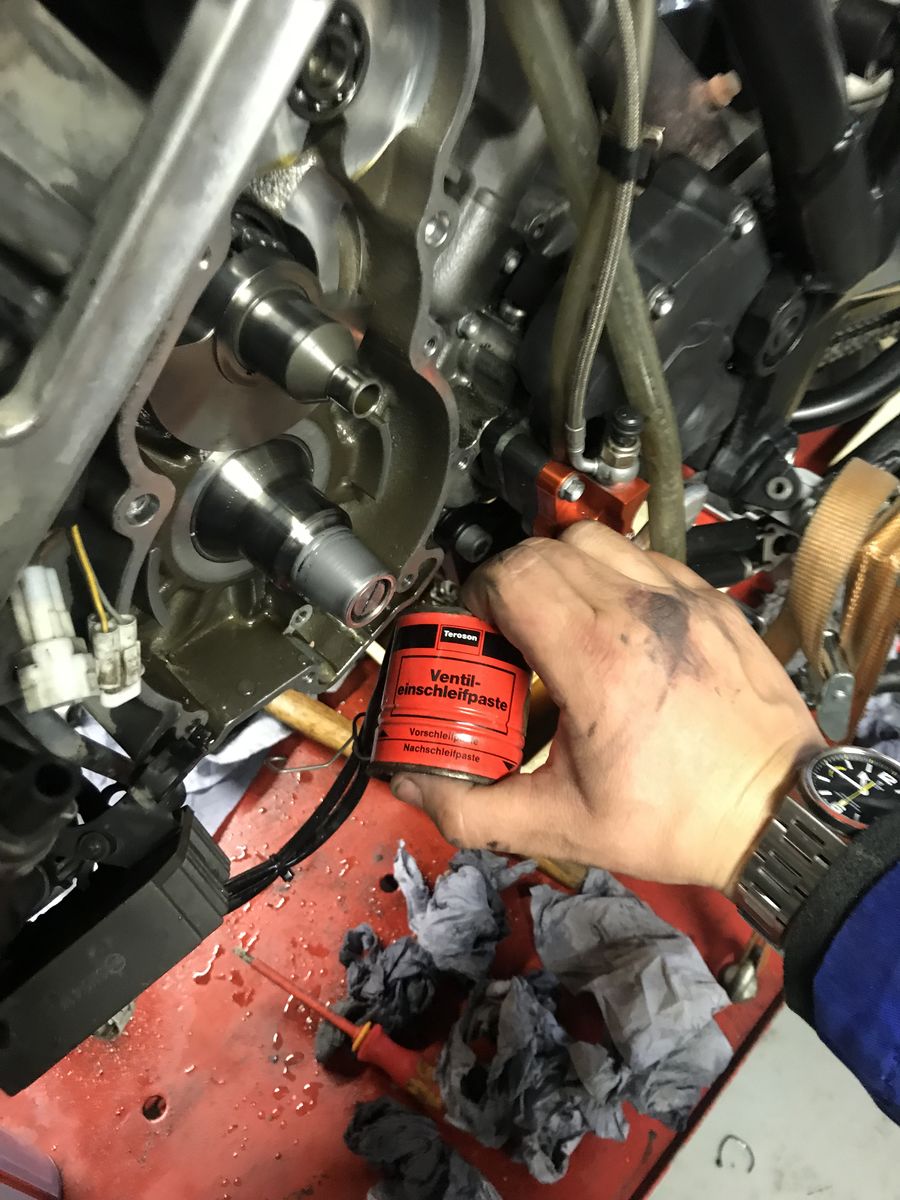

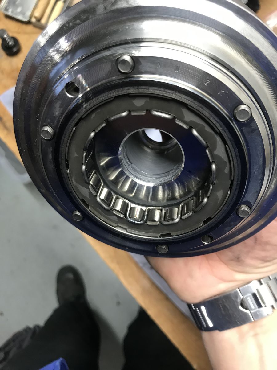

So.
Hier die Fotos.
Hatte ein leicht gefressenes Polrad.
Die KW hatte kein Passfederkeil. Dieser ist auch nur zum Fixieren und eher nicht zur Kraftübertragung gedacht.
Je besser der Kegelsitz der KW zum Polrad passt, desto mehr Kräfte können übertragen werden.
Nach dem Einschleifen aufeinander ist das fast wie "geklebt".
Im Anhang der Auszug ausm RepBuch.
Ebenfalls noch eine TI von KTM von damals:
KTM Technical Bulletin 0305 :
Check Rotor mount: It is required to check if the rotor allows itself to be removed with the rotor removal tool (No. 60029009000) at 120 Nm torque.
Before attempting to do this the front cylinder must be brought to TDC and the crankshaft locked with the locking screw. Immediately following the removal of the rotor screw please clean the threads in the crankshaft to prevent contaminants from entering the oil system. Install the push screw for flywheel extractor into the crankshaft and leave in place for the possible regrinding of the rotor-crankshaft interface to prevent grinding compound from entering the oil circulation system.
The regrinding is to be done as follows: After removing the rotor apply the finest grinding compound (preferably Teroson 114.78B / finish compound ) evenly on the conical part of the crankshaft and the rotor (with removed freewheel). Placing the rotor on the crankshaft apply axial pressure and turn the rotor repeatedly forwards and reverse through an angle of approximately 45°.
CAUTION: Too much material removal can result in a condition where the rotor may not become tight against the crankshaft anymore. Having been reground, the rotor and crankshaft must be cleaned thoroughly with brake cleaner and then remounted. Another test must be conducted with 120 Nm to see if the rotor breaks loose. If not, the rotor should not be removed again. If it does break loose, the rotor and crankshaft should be ground again.
Before the rotor is remounted the threads of the screw and crankshaft are to be thoroughly cleaned to remove all traces of grease and then Loctite 243 applied. 1 X Rotor cover gasket No. 60030040100 1 X Stepless one ear clamp 22.6 mm No.00050226706 ...

Für diese Info. Ich werde es morgen so machen. Hast du vor-und nachschleifpaste verwendet?
Nach wenigen startversuchen war das Polrad wieder nicht mehr richtig fest. Also morgen das ganze nochmal. Zum Glück habe ich gerade 2 Tage dafür Luft. Wobei das morgen vermutlich Max einen halben Tag, oder nicht mal so lang. Habe das heute schon deutlich schneller hinbekommen.
Und du hast das Polrad tatsächlich ohne Schraubenzsicherung eingebaut?
Mario
schlusiOffline
Anmeldungsdatum: 29.03.2008
Beiträge insgesamt: 400
KTM LC8 SM 950, 2006
 →  79.000 km
 →  115.000 km
Maico 500, EXC 200
BeitragVerfasst am : Mi, 29. Jul 2020, 18:04    Titel: Antworten mit Zitat
Hoi Mario,
ich hatte nur die "feine" Paste mit etwas Wasser genommen.
Es bedarf nicht viel.
Weiss natürlich nicht wie dein Verschleiss und Tragbild ausschaut.
Ich habe es trocken montiert und ausschliesslich die vorgegebene Schraubensicherung auf das Schraubengewinde der Polradschraube gegeben.
Warum ich kein Loctide Hoch- oder Endfest auf dem Kegel genommen habe, lag darin begründet, das du dort teils deutlich mit über 200 °C erhitzen musst, um die Klebeverbindung zu schwächen, wenn du mal wieder demontieren willst. Und das wär mir zu Viel in dem Bereich des Polrades und der Magneten.
Es verrichtet seit 15000km seinen Dienst .
Ich habe keinen Drehmomentbegrenzer (DMB) montiert.
Der Drehzahlmesser (DZM) wie oben erwähnt, sitzt bei mir im Cockpit, und hat mit dem Vorgang hier recht wenig zu tun Wink
____
