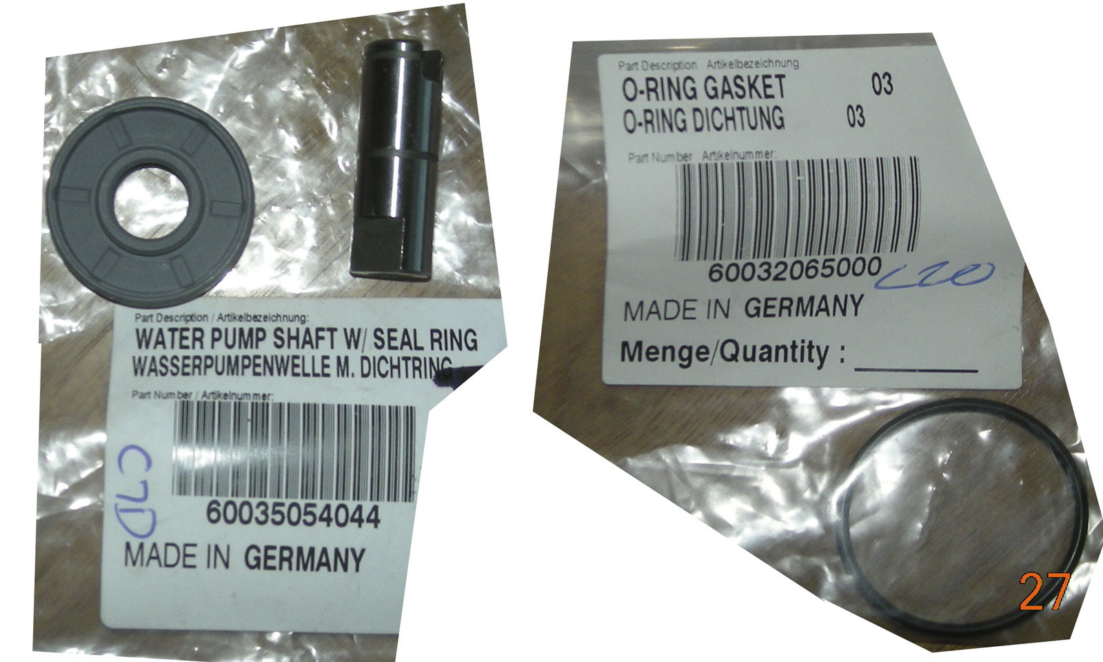

Moin,
duerfte mal wieder die Wasserpumpenwelle und Dichtungen sein. Such mal nen bischen im Forum, da findest du alles drueber.

Hi Nix,
To avoid further trouble in Marocco I would suugest to change the waterpump asap as its going to be pretty dam hot down there.
Attached picture with part numbers for the 950.
After refill with cooling liquid put the front wheel on the workbench and start bleeding and toping up. This might take a while until all airbubbles have come out.
Hope this helps.
